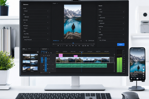

Setting Up the Right Sequence for YouTube Shorts
Getting sequence settings wrong is the single most common mistake when editing Shorts in Premiere Pro. Building your edit in a standard 1920x1080 timeline and exporting vertically produces pillarboxing, cropping problems, or degraded upload quality.
Follow these steps to create the correct vertical sequence:
  1. Open your project and go to File > New > Sequence, or press Ctrl+N (Windows) / Cmd+N (Mac).
  2. Navigate to the Settings tab in the New Sequence dialog instead of selecting a preset. No default preset includes a 9:16 vertical configuration.
  3. Enter the following settings manually:
Setting
Value
Frame Rate
29.97 fps or 60 fps
Frame Width
1080
Frame Height
1920
Pixel Aspect Ratio
Square Pixels (1.0)
Fields
No Fields (Progressive Scan)
Audio Sample Rate
48000 Hz
  1. Name your sequence something descriptive, such as “Shorts_Final_v1,” and click OK.
  2. Confirm the sequence by checking the Program Monitor. It should display a tall vertical canvas, not a wide horizontal one.
Pro Tip: If you realize mid-edit that your sequence settings are wrong, do not try to patch it with scaling adjustments. Create a new sequence with the correct dimensions and move your timeline clips into it. Trying to fix incorrect settings late in an edit wastes more time than starting fresh.

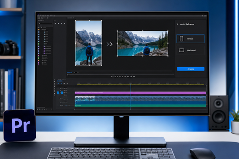

Using Auto Reframe for Horizontal Footage
If your source footage is 16:9 and you need to fit it into a 9:16 frame, the Auto Reframe tool can automate most of the repositioning work.
  1. Place the horizontal clip on your Shorts timeline.
  2. Go to Sequence > Auto Reframe Sequence, or right-click the clip and choose Auto Reframe.
  3. Set the target aspect ratio to Vertical 9:16.
  4. Select a motion tracking preset: Slower Motion, Default, or Faster Motion, based on how much camera movement your clip contains.
  1. Review the result in the Program Monitor and scrub through the full clip.
  2. Override manually when needed: Select the clip, open Effect Controls, and adjust Position and Scale keyframes to keep your subject centered through any sections Auto Reframe misses.
Pro Tip: Auto Reframe is a reliable starting point for talking-head content but often struggles with wide-angle shots or fast movement. Always scrub the entire clip after applying it before moving on in the edit.
