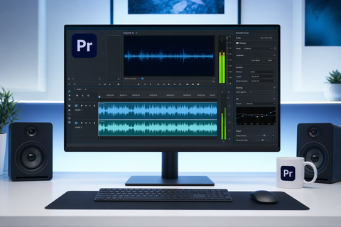

Step 4 — Enable Ducking and Set Parameters
With your music clip selected and tagged, look for the Ducking section inside the Music controls in the Essential Sound Panel. Check the box labeled Duck Against, then select Dialogue from the dropdown.
You now have three parameters to configure:
Parameter
What It Controls
Suggested Starting Value
Sensitivity
How loud dialogue must be before ducking triggers
50%
Duck Amount
How many dB the music drops during dialogue
-12 dB
Fade In / Fade Out
How quickly music lowers and recovers
500–800 ms
Sensitivity controls the detection threshold. A higher value means only louder dialogue triggers the duck, while a lower value makes the feature more reactive. Start at 50% and adjust after previewing.
Duck Amount determines the depth of the volume reduction. A value of -12 dB works well for most dialogue-heavy content. For subtle background music that is already mixed quietly, you may only need -6 to -8 dB. For prominent music beds, -15 dB or more may be appropriate.
Fade In / Fade Out values control the speed of the transitions. Longer fade durations sound more natural. Very short fades (under 200 ms) tend to sound abrupt and mechanical.

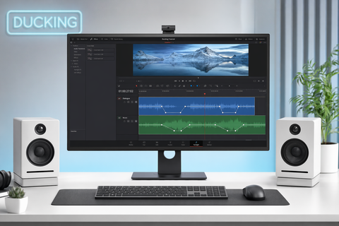

Add and Position Keyframes
For each section of dialogue, you need four keyframes on the music clip to create a smooth dip-and-return shape:
  1. Fade-down start — placed just before dialogue begins (music starts lowering here)
  2. Low-point entry — placed at the start of speech (music is now at its reduced level)
  3. Fade-up start — placed at the end of speech (music begins rising)
  4. Return to full volume — placed a beat or two after speech ends
This creates a U-shaped curve in the volume automation. The gap between keyframes 1 and 2 controls how quickly the music fades down. The gap between 3 and 4 controls the recovery speed.
Use the Selection Tool to drag individual keyframes horizontally to fine-tune timing, or vertically to adjust volume at that point.

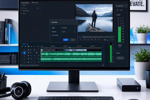

  • Ducking is inconsistent across the music track: Normalize the music clip before applying ducking. If the music clip has significant internal volume variation, the duck amount will produce different results at different points. Normalizing first creates a consistent baseline.
