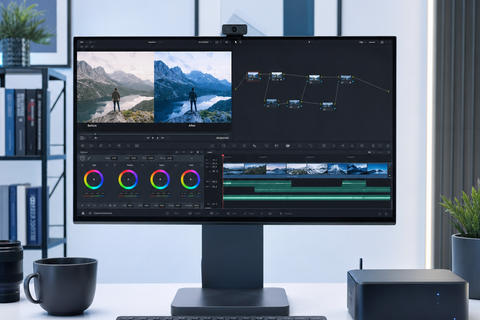

Navigating the DaVinci Resolve Color Page
The Color page is organized into distinct panels, each serving a specific function. Before you touch a single control, it helps to know what you are looking at.
Here are the primary zones of the Color page interface:
  • Viewer (top center): Displays the current frame. Use it as a reference, but never correct to it alone. Monitor calibration and ambient light affect what you see here.
  • Node Editor (top right): Where you build your processing chain. Each node is a separate, non-destructive adjustment stage.
  • Color Wheels Panel (bottom center): Houses the Lift, Gamma, Gain, and Offset wheels alongside Log wheels, HDR wheels, and primary sliders for contrast, saturation, and color temperature.
  • Curves Panel (bottom center, switchable): Access Custom Curves and secondary curve types like Hue vs. Saturation.
  • Video Scopes (top left or floating): Your Waveform, Parade, Vectorscope, and Histogram. These are your technical reference for every correction you make.
  • Gallery (left panel): Stores stills (saved grades) you can reference or apply to other clips.
  • Timeline Strip (bottom): Shows all clips in the current timeline, letting you navigate between them.
