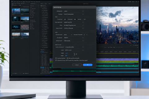

How to Create the Custom Sequence (Step-by-Step)
  1. Open your project in Premiere Pro.
  2. Go to File → New → Sequence.
  3. In the New Sequence dialog, click the Settings tab at the top (not a preset category).
  1. Set Editing Mode to Custom.
  2. Set Timebase to 30.00 fps (or 60.00 if your source footage is 60 fps).
  3. Enter 1080 in the horizontal field and 1920 in the vertical field under Frame Size.
  4. Set Pixel Aspect Ratio to Square Pixels (1.0).
  5. Under Fields, select No Fields (Progressive Scan).
  6. Set Display Format to Frames.
  7. Confirm Audio Sample Rate is set to 48000 Hz.
  8. Name your sequence something identifiable, such as “TikTok_1080x1920_30fps.”
  9. Click OK.
Your program monitor should now display a tall vertical canvas. If it still looks horizontal, double-check that you entered the frame size with 1080 as width and 1920 as height—not the other way around.
