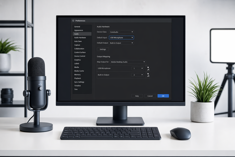

Set Your Audio Input in Premiere Pro Preferences
This step tells Premiere Pro which microphone to use. If you skip it, Premiere may default to the wrong input device or record nothing at all.
  1. Open Audio Hardware preferences.
  • Windows: Go to Edit > Preferences > Audio Hardware
  • Mac: Go to Premiere Pro > Settings > Audio Hardware
  1. Select your microphone from the Default Input dropdown. Choose the device name that matches your connected microphone or audio interface.
  1. Confirm the sample rate. A sample rate of 48000 Hz is standard for video production. Match this to your sequence settings where possible.
  1. Click OK to save the preference and close the dialog.
Note: If your microphone does not appear in the Default Input dropdown, the issue is at the OS level, not inside Premiere. Reconnect the device and check your system sound settings before returning to this step.
