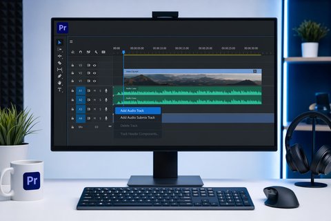

Fix 5 — Add an Audio Track if None Exists in the Sequence
If you created your sequence from a video-only preset or manually removed all audio tracks at some point, there is simply no destination for incoming audio. Premiere Pro will not create one automatically in all cases.
  1. Go to Sequence → Add Tracks in the top menu.
  1. In the Audio Tracks row, set the number to 1 (or more if needed).
  1. In the Track Type dropdown, choose the type that matches your source clip: Mono, Stereo, 5.1, or Adaptive.
  2. Click OK. A new audio track will appear in the timeline.
  1. Drag your audio clip onto the new track or multiple tracks, depending on your requirement.
Pro Tip: In some Premiere Pro versions (2023 and later), holding a clip over the empty track area while dragging will prompt an option to auto-create a compatible track. If the prompt appears, accept it to save steps.
