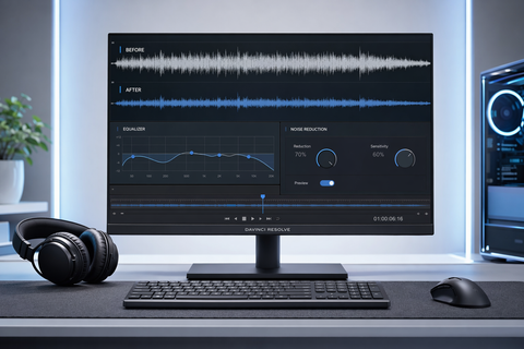

Step 3 — Sample the Noise Print
With the Noise Reduction window open, position your playhead over the isolated noise section you identified in Step 1. Inside the Noise Reduction controls, click the Learn button (sometimes labeled Auto Detect depending on your version). This instructs the algorithm to analyze the selected audio region and create a noise print: a frequency-specific fingerprint of the background noise floor.
Play through the noise-only section for a moment while the effect is in Learn mode. Once the analysis is complete, the effect stores that profile and will use it to identify and remove matching frequencies throughout the rest of the clip. If your first sample does not produce clean results, try selecting a longer or cleaner noise-only region and resampling.
Step 4 — Adjust Rejection Amount and Threshold
With the noise print captured, you now shape how aggressively the effect applies. These essential controls are:
  • Threshold: This setting triggers the noise reduction to start working. It defines a level where softer sounds count as noise. Anything above that level, like voices, stays clear and unchanged.
  • Attack: This setting decides how quickly the filter responds after spotting noise. It controls when the reduction begins once the noise is picked up. A quicker attack can catch sharp, sudden sounds, while a slower one keeps things sounding more natural.
  • Sensitivity: This setting controls how strong the noise reduction process feels. It decides how it separates noise from the audio you want. Higher values remove more noise, but can cut useful sound. This can make voices sound strange, like an underwater effect.
  • Ratio: Once the noise goes past the set level, this setting takes over. It controls how strong the reduction feels at that point. A higher ratio cuts the noise much more than a lower one.
  • Smoothing: With this setting, the reduction spreads across a longer time range. It softens how the changes are applied to the audio. This helps avoid sudden shifts and keeps the sound more natural.
  • Output: After noise reduction, your track volume can drop slightly. This setting helps bring the level back to normal. It keeps your audio loud enough after the noise gets reduced.
