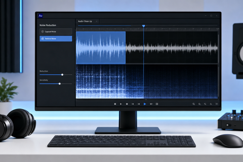

Noise Gate vs. Noise Reduction in Adobe Audition
These are two separate tools that solve two different problems, and many users benefit from using both.
  • Noise Gate silences audio that falls below a set volume threshold. It is most effective at cleaning up the gaps between words and sentences—pauses where room noise would otherwise be audible.
  • Noise Reduction (found under Effects → Noise Reduction/Restoration → Noise Reduction) samples a noise “fingerprint” from your recording and continuously subtracts it across the entire file. It is the right tool for constant background hum, tape hiss, or electrical buzz that bleeds under your speech as well as through the silences.
For most voice recordings, the best workflow is to run Noise Reduction first to reduce persistent noise under speech, then apply the Noise Gate to clean up any remaining noise in the silent gaps.
